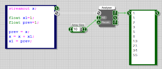

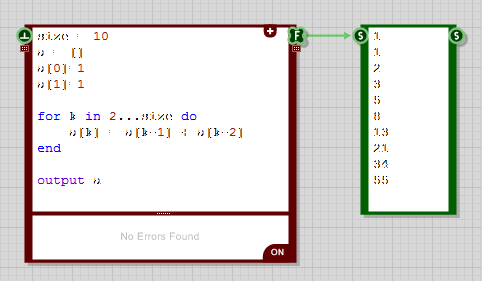

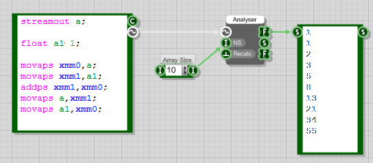

Some options for array creation are:
- buildArray3.png (16.95 KiB) Viewed 13618 times
- This one will probably upset tula ...
- buildArray2.png (10.82 KiB) Viewed 13618 times
- buildArray1.png (16.6 KiB) Viewed 13618 times

It does, Martin, it does. But for a good reason. It's not "the best" way as asked, it's the worst way, because it's not the Ruby way. A for loop is one of the worst methods, especially when doing large arrays, as the op said.martinvicanek wrote:...
But the other methods impress me! I would never had thought about using ASM, that's amazing!
