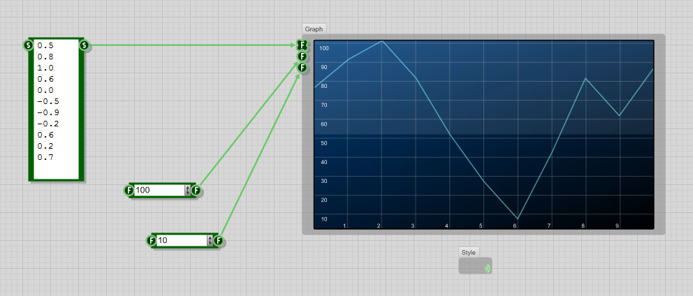

There is a Graph Module in FlowStone that takes an array of floats and draws a graph. If you look at the FFT Module you will see how it is done.
eg.
eg.
Graph.fsm- (3.41 KiB) Downloaded 1102 times

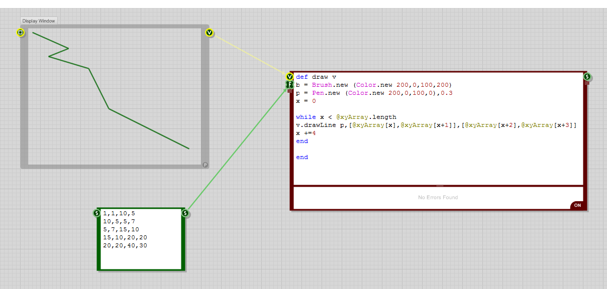

Yes correct but now we have Ruby there is a better way:
Ruby Graph.fsm- (1.08 KiB) Downloaded 1141 times
