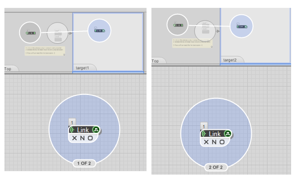

If a wireless link is connected to more than one target and a one is found by pressing the tab button FS immediatly crashes if the target is renamed and the tab button pressed again afterwards.
Maybe someone can confirm this?

it gives me the correct results! on tab press it gives me "1 of 2" target 1, pressing tab again gives me "2 of 2" target 2

I noticed such problem some time ago. I don't remember which ones, but there are cases (single and multiple wireless) when it crashes always, and there are cases when it works fine. Just go out of tab search mode, re-edit connector, and go back again to the tab search mode.
FS tends from time to time even to "latch" inexisting wireless connectors. Closing (yes, you can save it) and reopening the schematic helps.

Jay - click on parrent wireless, press tab (it will push you to the first receiver), and without going out of the tab search mode (still circle around) - rename the connector, confirm and press tab to go next. It should crash.

edit: yes confirmed! it does crash flowstone here aswell! it also labeled the connector as a source instead of a receiver!

i also found out another thing relating to this,
if you cut a wireless sender with cntrl+X and put it back with cntrl+V you create invisible sources, do it a few times and then go to the receiver and use the tab to find the source, you will see that there are more to find also if there is just one receiver and one source.
it gets refreshed when reloading the schematic.
