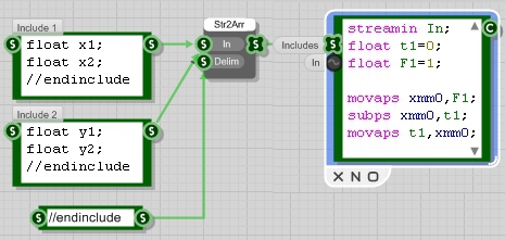

How can I create assembler primitive's string/integer/etc array input and output? Have seen somewhere on SM forum a schematics screen shot, but cannot figure it out how it was done in any FS manual. Basic example of how to add 2+2 with output appreciated. Thank you.

Assembler primitive is made for DSP (digital signal processing). It handles inputs and outputs on sample-by-sample basis. Currently it supports only floating point SSE input/output. Even if you connect green component to that input it will be converted to Floating point first. To process green data like arrays (of any type) use ruby component.

Thanks for clarification, but I bet I really saw a screenshot where asm primitive had a string array input! May be later I'll find it again to show here.

User108 wrote:Thanks for clarification, but I bet I really saw a screenshot where asm primitive had a string array input! May be later I'll find it again to show here.
I'm pretty sure you are either wrong or it was just photoshoped for use in context. the ASM in FS/SM has no instructions to handle strings or string arrays. you can't even (officially) input integers (although you can process them internally).

Thanks, Tester. Finally I've found it - here's asm with array input:
http://www.synthmaker.co.uk/forum/viewtopic.php?f=5&t=10248&p=76918
Seems to be photoshoped for a feature request indeed.. Hate Photoshop now))). But looks really cool.))
