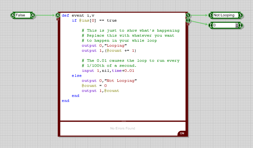

Re: Ruby: while statement
Try this, this uses the FlowStone events system to add a delay to the loop and therefore avoids an infinite loop.
while loop break.fsm- (523 Bytes) Downloaded 1250 times
Thanks for the very useful code, I see the delay is working and definitely needed, if I reduce it from .01 to .001 flowstone has an error.
I see how the repeating if statement is equivalent to a while statement but I have not found a way to break out of the event method. If I add a "break" statement in the else loop I get an invalid break error. See below.
The ruby part will happily run up to around 20Khz, ( 0.00005) but if you output this into the GUI system to display it you will overload the PC. Hence while it works ok at 100hz (0.01).
Remember FlowStone is a programming language and therefore you can do pretty much what you want, doesn't mean it always good programming though, so you have to think carefully about what it is you are doing.
