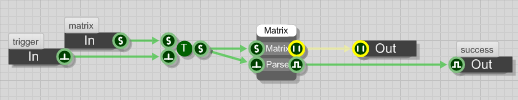

Postby oddson » Thu Jul 31, 2014 4:38 am
Of course you can make a module that has the intended behaviour of the primitive as follows:
