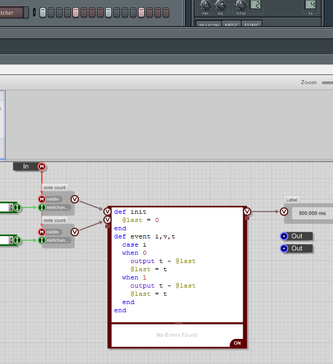

Re: Why FlowStone be late in FL?
With the script you've posted, the Label output 500.000 ms. Always, FL being stopped or playing...
Not sure at all if I'm doing the right test:
I tested your FL studio project and I can confirm that I also get latency. I dont know why it does that, but you can use plugin delay compensation on your other mixer tracks to get them in sync.
adamszabo wrote:I tested your FL studio project and I can confirm that I also get latency. I dont know why it does that, but you can use plugin delay compensation on your other mixer tracks to get them in sync.
Man, that's a pain!
This is just a simple/easy example, and there are lot of delay problems. Also because when I trigger more consecutive notes, each of them are out of sync.
Seems to be a huge problem this, working on FL. Or maybe I'm missing somethings...
