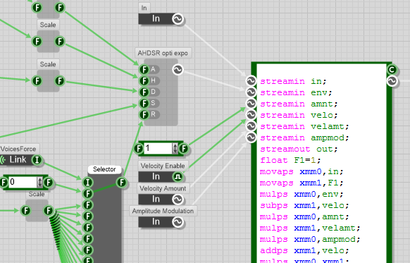

I found a way i just need some help how do the module working correct.
If anyone r intrested would be great.
I will show you in the image what i mean.
When you select 1 Voice on the porta it will make The evelope jump to a float says 0. with a selector in the amplifer envelope.
I just cant figure out a way to make it jump back to its normal release after u changed to 1 voices.
And then its pretty much finished. I think this will solve the problem it at least work pretty good here.

Its very anoying u cant upload little bigger image.
