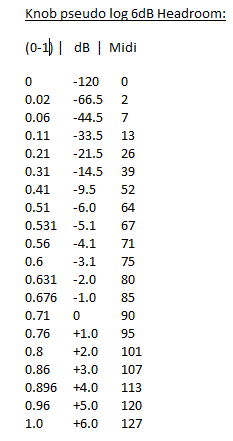

i'm again a little lost with my little mathematician knowledge here...
I need a Midi output value (CC 0-127) that mimics the behaviour in this RTF doc:
Thanks in advance!
Walter
P.S.: All values have an added 0.01 shunt (0.5 > 0.51 = -6dB, CC 64)...
i think i used this trick to compensate the rounding errors: float > Integer
Thanks in advance!
Walter
Knob pseudo log 6dB Headroom.zip- (10.48 KiB) Downloaded 722 times
- Knob pseudo log 6dB Headroom.png (302.01 KiB) Viewed 8675 times

Just a quick guess...
log 6dB (MyCo).fsm- (120.08 KiB) Downloaded 817 times

That looks more like a square mapping rather than (pseudo)log to me. Which is reasonable according to this reference.
Here is my attempt at an implementation.
MIDIvelocityMapper.fsm- (2.11 KiB) Downloaded 778 times

Thanks Guru's,
like i mentioned before - had no clue what's behind it...
Never would expect a Midi Velocity behind this curve martin...
Added a round float with 1 decimal => works fine here
Now it's time 4 a scotch...
Cheers,
Walter
