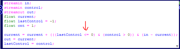

I'm having trouble getting anything out of this stream Sample and Hold module. If anyone could tell me what I'm doing wrong that would be appreciated!

The 0 crossing s&h need to rise from minus to plus to sample->

Thanks so much Nix!
Looks like whomever wrote this left out an equals sign.
Now it works in the 0 -> 1 case.
