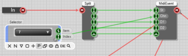

In relation to the request made on the Facebook group, I'm asking the question here as well.
How can I split MIDI channels to control a voice algorithm per channel.
I've tried intercepting a splitter and event:
and the scheme here:
DSP Robotics Support Forum: Process MIDI data?
Both seem to do nothing to effect the output downstream.
I've also been messaging Nix who says it has to be ruby coded, which is doable. Any suggestions for Ruby online campuses?
My goal is a MIDI guitar synth, which has each string as a channel. The big barrier here is the pitch bend per string. Most synths and samplers (with a single timbre) only have one pitch bender and dumps all the pitch bends across the played notes; which makes for a wrong and unrealistic performance.
I started a project in SynthEdit to realize this dream but 64bit doesn't allow for channels and recording pitch bend data internally to a parameter is not possible at this time; in fact, recording a single pitch bend's data internally is not possible at this time, as far as I can determine:

I've attached a very simple schematic that has the selector intercepting a splitter and event, with a single oscillator downstream. This is as far as I made it after watching a few youtube videos and poking around the manual.
I know, I have to read the manual!
Thanks for any consideration.

Hi,
didn't understood what is your most final goal. You'd like to stream the midi channels to some outsider channel in the DAW to power other vsti or you just wanna keep the stream internal to power your own synth?
And which version of Flowstone you used for this example? It doesn't get opened with 3.0.6 version.

The basic outline of the algorithm is:
6 channel selectors/splitters splitting 6 of the channels of incoming MIDI data to a separate oscillator with pitch bend data as a automate able parameter.

I'm focusing on the bare basics here, and tell things that you probably know. But I want us to talk about the same things, so let's find the common ground.
1) Every Flowstone plugin has a midi input.
2) Which channel this midi in stream represents, is determined by the DAW.
3) You can create a plugin that provides 6 midi inputs (actually any number, but here for the 6 strings), but the DAW must be able to handle multiple inputs per plugin
4) Which channel is used per input is determined by the DAW.
What you will never have is one midi input that carries 6 different midi channels in parallel. In serial progression it would be possible, but that defeats the purpose here.

Re: How Can I Split MIDI Channels
Figured out an algorithm, thanks.

I managed to do a midi separation by input channels with Flowstone version 3.0.6, however I have another scheme with the same structure in the same version and it is not working, I attach the first scheme that works:
I tested it with SpringBeatsvMIDI to virtually communicate Flowstone with Fl Studio and thus test the channels
