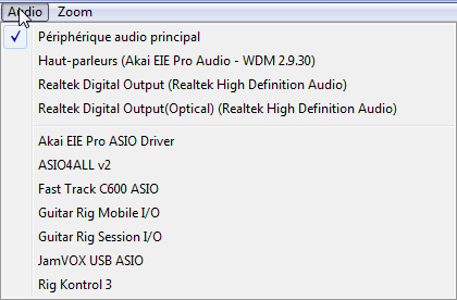

I am a newbie with Flowstone, but I have made some project with Synthmaker which is quite the same product, but music oriented. When creating the final executable, synthmaker is proposing the option to add a special menu within.
It is an "audio" and "midi" menu. So the customer can choose his drivers on his PC. Perhaps, this option will be available in the new version of Flowstone. Is there a way to do it with components ?

- menu.png (15.46 KiB) Viewed 17586 times

Re: Directsound Desactivated
Yes this feature was upgraded in FlowStone so you can make your own menus and have more control.
There is a module called 'Audio Selector' that gives you a drop down menu will show all of the active devices available for DS or ASIO.
Here's a working Project:
Audio Selector.fsm- (2.55 KiB) Downloaded 1153 times
