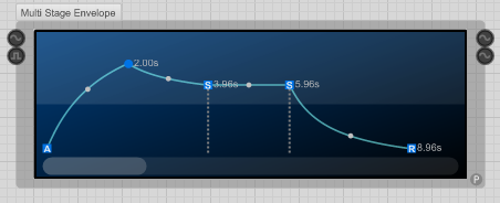

I'm using this fancy multi-stage envelope that I believe is included in one of the stock module packs.
Does anyone happen to know why the retrigger option isn't working? I'm running poly through it, works fine, but I can't get it to retrigger with new notes. I have the retrigger options in the MIDI to Poly set to true, and the retrigger option in the envelope module itself enabled, but nothing. I replaced it with one of the simpler ADSR modules just to test and they retrigger fine as long as the MIDI to Poly setting are enabled.
Thanks
Edit: forgot to mention I'm sending a poly signal limited to 1 voice.
Thanks

I have the exact same problem: No retrigger in any mode with the stock multi-env. It just sits at the Sustain level and ignores new notes until the existing note is released (MIDI set to 1 voice). The stock basic ADSR retriggers fine in the same schematic if I replace the Multi-env directly with the ADSR.
If I right click inside the module's GUI there is an option to retrigger or not. It looks like the code for the envelope is ignoring this setting. I've tried having Gate not set and set with a wired connection and still ignored.

EDIT: I've managed, after many hours, to fix this. Dead simple fix as is often the case when you find it. In the section manager there was a line
GateAcc = GateAcc | gate;
The GateAcc float was then reset to zero and never got changed so I changed it to
GateAcc = gate;
I couldn't see a use for the GateAcc float actually. Someone's going to explain it to me for sure though
I also deleted the contents of the strings for Retrigger On and Retrigger Off in the Right-click module, since they do nothing anyway. You can alter the retrigger possibility on the MIDI side so I don't think anything has been lost by the modification. The various right-click settings all seem to still work ok and it's not necessary to wire in the gate connection.

I'm such a noob when it comes to dsp code, but from my coding knowledge, I dare to say that this multi-envelope is a work-in-progress that was never finished (some functionality isn't implemented, or only half-way through, for example "fast release").
If you select Retrigger from the popup menu, the boolean is sent only to the section player module. The dsp code in there uses it reversed in just one line of code:
Now this contributes nothing to getting out of a section and re-starting the envelope. The boolean RetrigOFF is false if you select Retrigger ON. RetriggOFF is or'ed with (section>0), which is true from the beginning of the attack section until finished.
The other module, Section Manager, stays in the sustain section until releaseOn is not 0. This last var is set by (basically) the gate input, and the gate input is triggered by the third module, Finish. And Finish checks its env input which is the standard env prim. This sends either 1, 3 or 4. 1 means on, 3 execute and 4 release. Finish sends true to the gate output if env sends 3, and false in all other cases. But finish is triggered only after the sustain phase (of course, it's a finsher).
The Section Manager is the root of the issue, I'm almost sure. But since my dsp code knowledge is so low, I don't really see an error in the code. It seems to just miss code (and an input) to get out of sustain and restart the envelope on retrigger. But that's up to the dsp gurus.
waveTemp = polarity - (section>0)|(RetrigOff)&(polarity - waveTemp);
