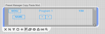

I have a preset manager i edited. And when click menu or Rename. or even the < > I get this selector menu with presets all time.
I cant find the problem.

Re: Help with easy thing. Preset manager selector size.
You've got all Preset Manager sub-modules, stacked on top of each other.
So no matter where you click, the Selector menu will activate.
Move the re-name and <> selectors down, like this
To understand why this all happens, investigate all MGUI circuits in the Preset Manager.
- Posts: 1165
Ah ok so u cant have the preset manager like that?
- djbrynte
- Posts: 613
Used an old one I had lying around so not the same as yours, no copy paste, and the property's panel is messed up
but shows it can be done.
Nice bro i will check
It seem its possible like u did.
