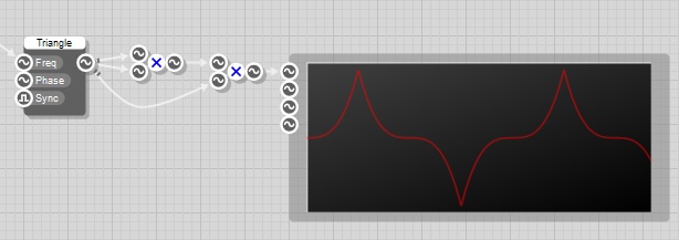

Hey guys,
I am just wondering if anyone has a formula or a way to create a similar curve? I think I got something similar by accident by multiplying a saw with a sine or a triangle, or a sine with another sine, I dont remember, maybe someone has any ideas? The point is that it should be like a sine, but then it has these parts where its at 0 for a while then goes negative, then continues like that.
The tops are not flat like in my image, thats just a crappy quick paint job, they should be smooth like the top of a sine

I just remembered that a triangle multiplied by itself 3 times gives something similar, but the peaks are too sharp and not sine like.
- tri.jpg (33.14 KiB) Viewed 13692 times
