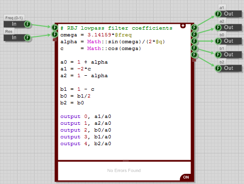

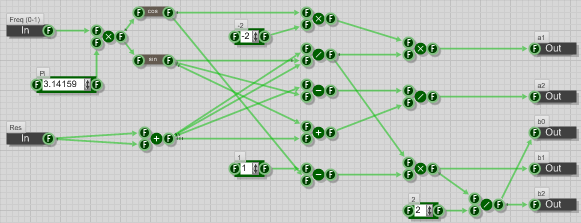

Math is very easy to do in Ruby and a good entry point for noobs like me. Here is another example which shows the advantage of Ruby over green math: a simple biquad lowpass filter coefficients module. This is how a green math implementation of the RBJ cook book formulas looks like:
And this is the same in Ruby:
I find it much faster to set up in Ruby, and certainly much easier to debug!

Re: Mathematical variables (Ruby)
martinvicanek wrote:And this is the same in Ruby:
Small tip: PI is defined in Math, so
omega = Math::PI * @freq
gives you higher accuracy
You are right. It is faster to set up and easier to debug. But don't forget, this is for us, people that already programmed with another programming language before. Those that never programmed before will love that they can program visually instead!
On the other hand, without Ruby I would never have been able to realize the spline module. A nightmare thinking about how to do that in green!
In the end, I think, that means to start in green, then slowly start to simplify things with Ruby modules, until you're experienced enough to do the whole thing in Ruby.
