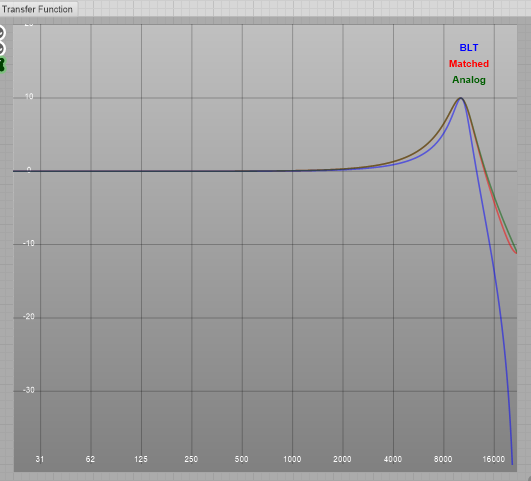

Actually the SVF parameters (cutoff frequency and Q) are much closer to the analog world than are the biquad parameters a_i and b_i. But SVF is only 2nd order.
3. Can you grant a short explanation (for layman reader) regarding some of your terminology, like "matched biquad", "static" vs "modulateable", etc. What does this mean? What is the difference with your filter designs, compared to the standard Flowstone modules? In a few sentences, please.
Analog filters have some nice scaling properties: in a double log representation of the magnitude response, changing the cutoff frequency results in a mere shifting the curve without changing its shape. Digital filters do not have this property per se because the Nyquist frequency poses a fundamental upper limit. There are various possibilities to make digital filters resemble the behavior of their analog counterparts. Perhaps the most popular is the bilinear transform (BLT), which maps the analog frequency (from 0 to infinity) on the Nyquist interval. The famous RBJ Cookbook uses BLT. The formulas for the filter coefficients are simple and explicit. The downside is that the mapping is not perfect near Nyquist, the effect is sometimes called cramping.
Matched filters intend to better reproduce the analog filter response at the expense of more complicated coefficient formulas. I have included a little demo, here is a snapshot:
