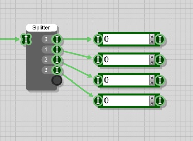

Using map as you suggested Tulamide, to spit out 0,1 integers from Ruby box will work perfect for now I think 8-)
Took a while but seems to work with my reset schematics and insane amount of selectors :D after some additional trigger blockers and "changed prims" etc to avoid potential trigger storm and unwanted triggers during knob movements.
Guess there will be a little extra overhead since alot of knobs are sharing the same string, that has to be updated, but shouldn't cause problems I hope. I'll keep my structure as is and let the strings be around max 30 chars per preset.
Going to try and implement it with dropdowns eventually. Have to see first if using strings this way is stable when scaling up :lol:
