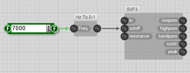

I cant seem to get the right audio frequency when I have a static frequency. No knob, no movement but I cant figure out say 7000hz would be on the knob. Attached below is a high pass I want to have with a static frequency of 7000Hz but also has a gain knob to control the volume of said 7000hz.

I'm not sure I understand everything. For example this
doesn't make sense to me in your specific case. However, the SVF expects the frequency in normalized format (0 to 1, where 1 is nyquist)
Do it like so to set a specific frequency in Hz.

Oh, I see!
I don’t know why I didn’t think of that.
Thanks so much!
