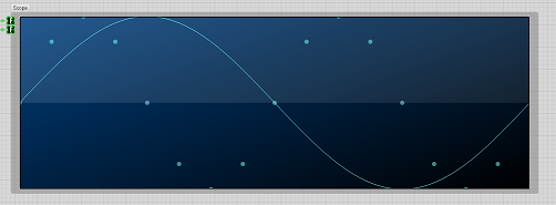

Thanks for the help and the fancy module :) Tried to edit the input signal with a sin. But it messes the graph, not sure why:
Here's the DSP code:

Schematic:
SincInterpolation_Sine.fsm
(10.04 KiB) Downloaded 855 times
Sometimes, it draw correctly :) Where's the bug? Thanks

I think I've got it! I just need to retrigger the [F] SyncInterpolation module, so it propagates the changes ;)
Thanks boss!!!!
