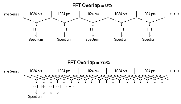

The overlap seems to be something rather simple. From the help file - it looks like this (attachement).
I wonder of there are other ways to calculate the FFT itself (math and steps behind). Maybe this is simpler than we think?

Ah yes - much simpler with a diagram, got mixed up somewhere understanding the text, I think.
Great, that will simplify things - I'll take the phase maths out of the code and see what improvement it makes.
