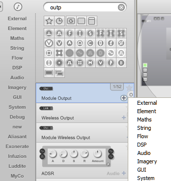

Just started working in Firefly...
1st all went fine but suddenly mainly all default Component Tags disappeared... see pictures:
(External, Maths, String etc. all empty...)
btw: Focus mode dosn't show full screen if GUI size = max Monitor size (1920x1080)
Walter
Walter
- Component Tag disappeared.png (42.72 KiB) Viewed 8127 times
- Only one Component in Element TAG.png (23.82 KiB) Viewed 8127 times

Report:
1. After Restart: no changes
2. archived AppData\Flowstone folder
3. reinstalled FS 3.02
4. checked archive and actual Tags folder => in archive(bugged) all *.tag files where missing!
5. only original user modded tagbar.txt exists
6. all shows up again now
