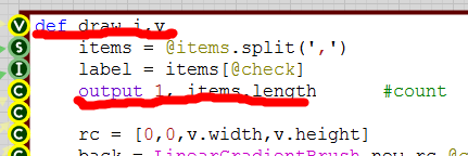

Re: RUBY: Droplist selector uses massive CPU when copied
This is what I'm referring to.
But the two lines above it also doesn't belong into a drawing method, since they create anarray from a string and evaluate one of the created values. That's all time consuming, when several redraws take place. The method is called "draw" for a reason
