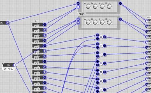

Postby lalalandsynth » Sun Sep 30, 2018 6:52 pm
Yep, this works, except it went back to a mono signal, checking if i did something wrong.
I changed the one you made to work with 12 stereo channels or 24 mono ,so each note was triggering a stereo channel.
With the ADSR that is lost and I am back to mono.
I can upload my schematic if you can open an alpha ?

Postby lalalandsynth » Sun Sep 30, 2018 7:02 pm
With this configuration through the adsr I get mono.
Ones below are from before with no ADSR and they work as stereo.
Must say , I am a bit frustrated that my skill level is so low that I cannot figure this out .
I could obviously just have 2 Adsr´s with one set of controls but that seems like a workaround ;)

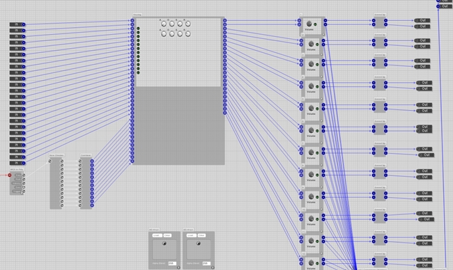

Postby lalalandsynth » Sun Sep 30, 2018 7:10 pm
Stereo configuration

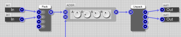

Postby martinvicanek » Sun Sep 30, 2018 9:36 pm
You can go stereo like this:
Simply pack and unpack the L/R channels into a Mono4 stream - everything else remains unchanged.
There is a lot to optimize but that's for later. Thanks for the donation! :D

Postby lalalandsynth » Sun Sep 30, 2018 9:40 pm
Thanks again , so simple ...unless you dont know how :)
