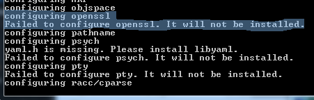

Well i noticed that when I compiled
c:\ruby-build> nmake
When it came to installing openssl, it just said failed! I cant remember if it gave a reason. . .
Am I doing this correctly? To say that the "$LOAD_PATH. . . " line tells Ruby to look into that folder for files too?

Postby Drnkhobo » Wed May 15, 2013 6:51 pm
Yeah it compiled fine, just not with the openssl libs.

Postby digitalwhitebyte » Wed May 15, 2013 11:03 pm
Ok, now to install rubygems there are still two libraries to compile, yaml and zlib from source,
a bit complex to do.
I try to tidy up the procedure and ready as soon as I add it to the original post.
however this is done,
every time you install a rubygem will always have to launch the file vcvars32.bat first before giving in the console, the command to install the gems.
and verify that the environment variables in the PATH variable there is the path of the ruby that you compiled.
this need because some gems is compiled from C code,
and ruby need to know the paths of the compiler in use on the system.
but keep in mind that they did all this, some gems will not be able to function,
because the code will turn off if a thread takes too long to finish its execution.
especially with executions of code to use web connections, they use a socket that is executed in a loop running,
it definitely will block the ruby code.
