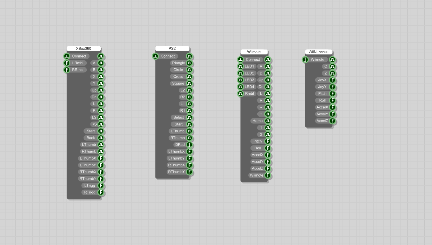

I would just use an Xbox controller or a PS2 controller (from LynxMotion) as these are already fully supported. Another option would be to use the Wii Mote:
Games Controllers.png (123.63 KiB) Viewed 19049 times

Thanks, but I need a one hand 6-axis controller like the 3DConnexion Spacenavigator or the SpaceOrb.
The initial plan was to connect the internal potensiometers to the analog inputs of a Phidget interface board. But when I opened said controllers I found out they used optical sensors, not potensiometers, so that won't work. :(
