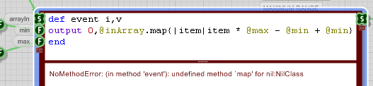

Thanks nubeat7....but i keep getting method error for map!...
changing code from '@inArray.map!' ...to. '@arrayIn.map!' didn't work also...

Yeh..it goes...i figure the error was using string array input instead of float array?
