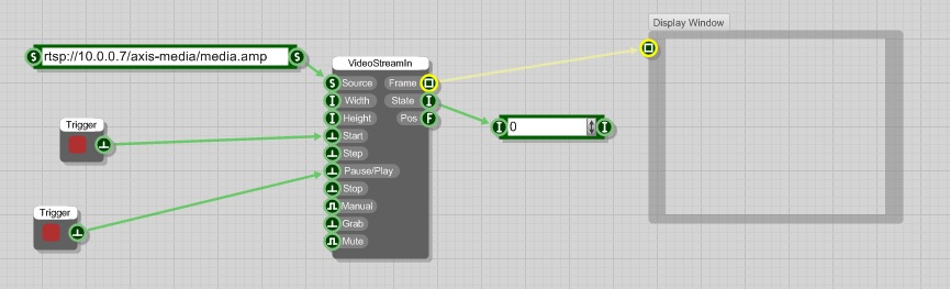

Just got an Axis Q-1755 IP camera, the url in the schematic below gives me video in VLC, but nothing happens in Flowstone.
What's wrong or missing here?

I think it only works with HTTP?
