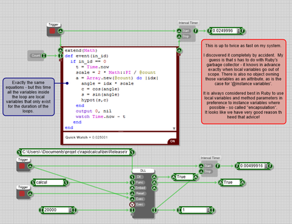

hi guy's ,
I test your benchmark trog well and thank you for this nice work
I wanted to test how quickly a dll following (and respecting your code of course)
see how time put with a dll.
and the result is interesting outright I see attached below the fsm and the project dll to prove my good faith: p
a screen capture on my pc to the result obtained
and now the project file and the fsm
C + + is faster is normal this is not an interpreted language but I will think that to load a dll in memory have done it but not waste time

wow its about 5 times faster here on my computer, thank you very much for providing this example!
Re: Red vs. Green - vs. the Developer!
Wow! - thanks a lot, Mmix, that is a excellent demonstration - the perfect completion of the benchmark comparison.

RJHollins wrote:It seems that clicking the 'trigger' to start the test will yield different output times [most notably the very last test routine]. I get timing results like this:
There are a few reasons for this...
- The RTC timer is using green triggers to start and stop, so the precise moment will be missed by a short amount as the triggers are processed.
- Your CPU is doing other things besides running the test schematic - so the times vary according to the CPU's task switching.
- There will be times when Ruby's garbage collector has to come along and free up the memory used by temporary Ruby objects. This only happens occasionally when Ruby feels it is running short of space on its memory heap - so once in a while you just get unlucky. Something similar possibly goes on behind the scenes with 'Green' trigger management.
You will generally get more reliable times if you increase the count. I kept the number fairly low for the download because I don't know what CPUs people will be testing on - if the number is too big, Ruby goes splat!
