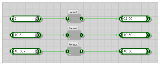

Those examples are very useful, but I am at moment stuck with a simple problem when converting a float to a string. I need a specific format ##.##, for example 2.0 float should yield the string 02.00 and 10.5 -> 10.50, in addition 10.499 and 10.502 should be rounded and yield 10.50
Is there any easy way of achieving this? I looked in the palette of modules and the documentation and didn't find any suitable module. I guess, I have just missed something obvious...

There is a nice String Format Module:
I stole this out of the 'Float Label' module
String Format.fsm- (706 Bytes) Downloaded 1302 times
