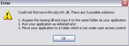

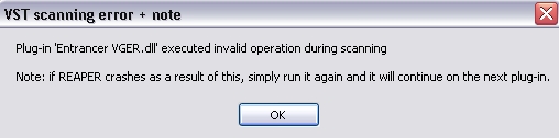

Here are the 2 errors from Reaper, Win XP 32 (SP3). Intel Core 2 Duo @ 3.16GHz, 4GB DDR2 memory
This version has no ruby components
This version has an empty ruby codebox
What can I do?
What can I do?

Re: My synth is incompatible with XP SP3{cry}
The ruby dll currently is wrapped up with the plugin dll and extracted to the App Data folder when the plugin is opened. We're trying to see if there is a better way of doing this but for now this is how it works so the dll should be present on the user's XP machine.
For XP the App Data folder is here:
C:\Documents And Settings\[user name]\Application Data
Check if the dll is present in that folder. If it is then it could well be the same issue that billv had with missing elements from XP, in which case there is a suggested solution there on the thread you linked to above that is worth trying.
@nix
Downloaded your plugin - works OK on both of my machines, even if I rename the installed FS version of the .dll so that it can't be found elsewhere. Both machines are XP32 SP3 (Atom N270 and Q6700 CPU's) - so it's not XP per se that's the problem. I've only had one or two FS crashes the whole time I've been using it, and they were most likely just my experimental dabbling.
OK-
We got it going.
It required the .dll in the C:\Documents And Settings\[user name]\Application Data
Probably security permissionms did not allow the plug to unpack it to there.

We got it going.

Re: My synth requires security permission to install Ruby...
nix wrote:security permissionms
Hey , I need to clarify something here, as my synth is ready for release, and I want to avoid
any installation issues by the user like Nix experienced here. I'm on XP, and ignorant of these
permissions and adminstator stuff.
