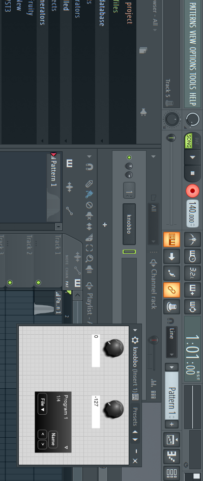

I'm using FL20->
knobbo test90.png (97.58 KiB) Viewed 19610 times
The animated knob is still playing back atm without any bool on the send recording pin

Postby tulamide » Mon Jul 16, 2018 10:53 am
nix wrote:I'm using FL20->
You still haven't understood. What you are showing is the receiving part of my post, not the sending part. The sending part would be, that you enable send automation recording, and in your DAW you enable, say your mixer's volume slider to receive these values and move up and down accordingly.
