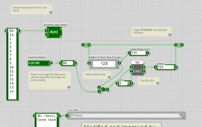

Have recently made the transition form SM to FS. In the process, I've been able to improve my first project with the addition of RUBY's flexibility.
There is a MAJOR routine that I've been trying to convert that has me perplexed.
History ... I was fortunate to have 'TROG' make modifications/rewrite of a 'dual input' edit box routine. The initial 'design' needed a double mouse click to activate the edit box. The 'dual' inputs stem from data that can come in from disk that pre-loads the Edit Box. This box can also handle User input data. [this is a rather straightforward need in an app].
Now enter FS with RUBY.
Now I would like to find a better solution with FS {Ruby].
The 'design' idea has changed somewhat ... the double click to edit is something that I've reconsidered. It now seems just a single click would be more user friendly.
In the enclosed schematic I've included the TROG MOD'd [SM] version, along with my attemps in FS. Because this User data gets placed within the GUI of the app ... I need to apply restrictions to the entered data ... some are to maintain the GUI appearance, and others are to provide additional user friendlyness
My call out to the GURU's ... this is such a fundamental requirement for all different kinds of apps. I've been all through the forums researching a solution, but have come up short.
Any help getting this realized would be most appreciated. I'm sattemptsurfriendlinesse many others would find this useful.

Boy this is tricky ...
With a single click in the edit box, I'm able to edit the entry data ... but the 'text' is disappearing until I hit return
If I lift the returning feed line [that supplies the TRIM function], the editing display is fine. [but obviously the trimming is skipped].

By itself, clicking and entering data seems to work fine ... the text is visible the whole time. The problem shows up when looping back into the module ... text disappears until you hit [ENTER] or leave box.
But there are other issues with this ... at least with my minimal experience with RUBY.
It seems the design of this 'Edit Box' works on a different concept than I was expecting. There seems no true text variable in this RUBY code, or at least one that can be 'internally' controlled. I was looking at how to add 'string formatting' option [left, center, right], along with additional controls.
I really need a user input text box that can be programed to be, what's called, 'user friendly'.
That said ... I'm left questioning if my approach of 'dual input' is even a correct way to do things
I have lots of edit boxes that data is entered into, this gets Save to disk as a separate 'configuration' file. The user needs to be able to modify these entries AND these boxes must handle data be loaded back in from disk.
