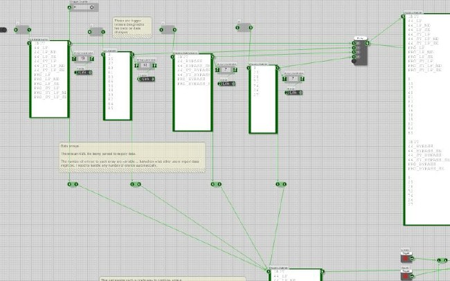

I very much need advice on a very fundamental aspect to most projects I'll be working on.
I've put together an example schematic that outlines a common scenario, and am hoping to get some guidance to get a design that works best.
In my example, I stayed with FS primitives ... I'm certainly not opposed to using some RUBY ... but, I'm still novice with FS ... let alone RUBY
I've try to comment section of the schematic, as I have presented 2 concepts that I've tried to use. The 2 are NOT compatible [in present state] with each other. Each has +'s & -'s to the way they work.
What I hope for is a system that I can implement that handles whatever number of arrays that I may need for a project. The 'size' of these arrays could also vary ... in fact, I have situation where a User loads in an XML file that I'm parsing [as configuration data] ... I won't know the number of entries, so I need to have flexibility.
I'm saving this data to the MY DOCUMENTS folder, and then auto-loading it back in to separated arrays that can then distribute this data throughout the schematic [I've included a typical pull-down menu that I'm feeding with this data.
I could really use some advice and guidance to, once and for all, get this core function resolved in a clean, solid way.
Pre THANKS for all that look at this

I have finally been able to reproduce the issue my bud was having ... this is a step forward.
I'm thinking my text arrays are just to bland
When the file gets reloaded, the number of entries for each of the arrays [using the SPLIT prim], can easily reset to ZERO [because the original XML file was not loaded to establish the variable]. This makes sense, and is really a bad way for me to program this logic. Must fix.
I'm wondering if including some type of HEADER in the config file that would contain each of the array sizes could be used to set all the other array Splits ???
just stinkin' out loud

mmmm .... first test using the Marshal 'plan' ... works !
I only used the 3 arrays from the example I posted above ... hooked up everything.
The output was sent to 3 arrays, and viewed with the TEXT prim on each. MAGIC
ok ... got to play with this some more ... if working like this, then test integration into my current project.
I'll post up the schematic with the Marshal Ruby.

RJHollins wrote:Is this crazy ? am I out of my mind ... .......... yet ?
Your logic seems sound enough - verify the contents of the save by re-loading; useful as you might otherwise not see it if the save fails for some reason. Windows 7/8 can be buggers for this as they'll sometimes not save a file as expected because of file permission, but without displaying any error!
To simplify the schematic, I'd suggest doing the delay completely inside Ruby - you can schedule an input or output event to happen some time later very easily.
To do this you use the 'input' or 'output' methods with a third value, which is the time that the event will be sent
def event(in_id)
case in_id
when 'load' then load_arrays
when 'save'
save_arrays
input 'load', nil, time + 1.0 # 1.0 is the delay in seconds
It's pretty cool that a Ruby prim can send events to its own inputs like this - but beware of doing it for inputs that actually take a value, as it might clash with whatever value is coming from outside. But it is always safe for trigger inputs.
The 'nil' in this case is just a dummy value, because trigger inputs and outputs will ignore the value anyway. 'nil' is built into Ruby, and is just a completely empty object - so is handy for this as it uses no memory.
The same thing works with the 'output' method, e.g....
output 0, "Hello", time + 1.0 # Send "Hello" to output 0 after one second.
In this case it is safe to send an actual value - but if all you need is a trigger output, just set the output to be a green trigger type, and you'll get a trigger every time you send ANY output value.
You must remember to use the built in "time" variable when calculating the event time for delays, because the time is absolute (seconds from startup) - so to delay an event, you add the delay to the current time.
The timing will also be much more accurate than a green trigger delay too - if you have audio running in your schematic, right down to a single sample of delay!
