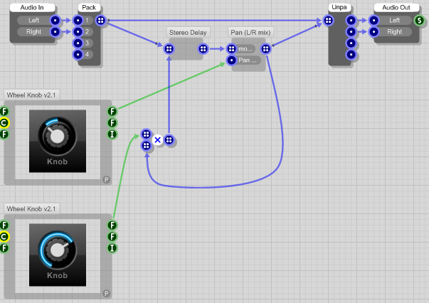

My current project has a feedback/delay loop with a L/R pan control inside the loop. As you'd expect, a non-neutral pan value causes the feedback signal to progressively travel to the left or right. I decided I wanted to add a switchable "ping pong" option such that the feedback signal bounces between the left and right. I can easily swap the left and right signals per cycle, which is the basic concept of the ping pong, but the problem that arises is that the pan function always pans in the same direction. Desired operation would be if the direction of the pan swapped along with the left and right signals. I'm not sure of a reasonable way to achieve that.
Here's a simple diagram showing the basic setup. It's just a feedback delay with a pan module. It carries a stereo (mono4) signal.
Is there a reasonable way I can make this ping pong without re-writing the delay and pan modules into a convoluted mess?
Thanks in advance.
Thanks in advance.

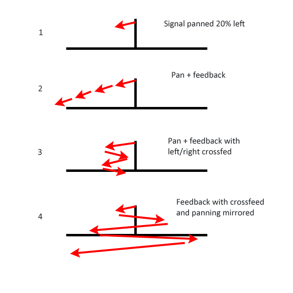

Re: How To Make Feedback Delay Ping Pong
Refer to the diagram I posted above then check this out. This is what happens.
1 & 2 are desired operations. 3 is what happens if I just crossfeed the signals (as per typical ping pong) with the pan function inside the loop (the signals are flipped but the pan is always the same direction). 4 is what I want to achieve with the ping pong (the pan is flipped along with the left/right signals, progressively panning towards the outside like number 2).
