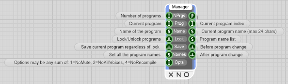

@CoreStylerz:
Man! - where did you get this info from???
I disabled all Modules in my standalone effect because i had dropouts while changing presets...
Only 2 find the Preset Manager is the bad ass...
No doc or Changelist Info about the new Options Input in the Preset Manger: 1=NoMute, 2=NoKillVoices, 4=NoRecompile
1=NoMute did it 4 me
cheers,
Walter
P.S.: Just found out that my Preset Manager Modul in my Toolbox missed the Int 7(default?) in the Options Input...
Make sure that preset manager is not set to recompile, kill voices.
cheers,
Walter
- Preset Manager Options FAQ.png (28.21 KiB) Viewed 12839 times
