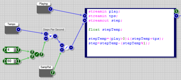

I'm testing a sort of "Sequencer" that need to work on the current step of my DAW/Hhost: FL Studio in my case.
I will vary Tempo BPM during the time, so the app need to be in sync with it:
I'm working with "blu/mono" stream data type, but if you change Tempo BPM of FL Studio and you look at the Mono connector, you can clearly see that often steps (for example the first when the pattern retrig) is out of sync.
What's the problem here in your opinion?
Tempo prim between FL Studio and FlowStone it is not as fast on refresh?
Float rounding errors?
My wrong math on calculating step?
Note: I know Tick25 is not accurate to reading data from M2F, but even placing a PPQ prim (which is more accurate) change nothing. So it is not what I'm reading that is wrong I guess; its the whole step that arrive to Mono Readout that is already incorrect.

you cyn use ppq , so its always nailed to the actual position
i did a sync module for steplfo you also need to calculate different in fl studio then in other daw's which is really stupid sadly there is no chance to automaticly change the calculations for different daws, it needs to be done manually

But PPQ it is not constant due to the BPM tempo change. I mean: if I change it, the PPQ won't resize accordly. It just sum actual values. For example: in a pattern of 4 beats, if first I slow down the tempo and than I pitch up, I can end with values > 4.
Yes it works if I don't change "live" BPM on the DAW (as mine works):
but when I move it, PPQ totally goes messy!
And anyway, I don't know Assembler unfortunatly

Nowhk wrote:But PPQ it is not constant due to the BPM tempo change. I mean: if I change it, the PPQ won't resize accordly.
i don't know what you mean, ppq is pulses per quarter and should show always the actual playposition in pulses (or ticks) per quarter, so it has nothing to do with the speed at all it just shows the actual playposition in your song..
just tested it in cubase and works fine there, always nailed in sync, but sure, at fast tempochanges the play position jumps back ( at least in cubase, didn't test the reaction in other daws.. ) but still you always have the correct playposition to keep it synced to speed and position, it will be different when you want just temposync but no position sync, then the tempo prim is fine, the problem is that in most cases it will produce small rounding errors which results in running out of sync over the time, but this shouldn't be too bad for shorter play times or lfo's which always get restarted at noteon
the assembler code is not too hard, here is the basecode in dspcode..
// code by Nubeat 7
streamin speed;
streamin stepst;
streamin beatcnt;
streamin PPQ;
streamout steppos;
steppos = ((PPQ*speed) % beatcnt)*steps;

Sorry to tune in, but this whole discussion was already done before, when PHI had a similar issue. It turned out that FL Studio ignores the VST Standards and outputs wrong values for ppq.
viewtopic.php?f=3&t=2732&p=14733&hilit=ppq#p14733
Re: Why I'm not able to stay in sync with DAW using stream/b
tulamide wrote:Sorry to tune in, but this whole discussion was already done before, when PHI had a similar issue. It turned out that FL Studio ignores the VST Standards and outputs wrong values for ppq.
yes, also the difference between tempo sync and "positionsync" using the ppq is described there..
also with the fact that fl studio calculates the ppq differently when changing the timesignature from 4/4 it should stay in sync with the correct calculation, (there is already a flag in my calculation module for fl studio)
but yeah maybe its an fl issue again, wouldn't be exceptional..
you should compare the behaviour with other daw's
