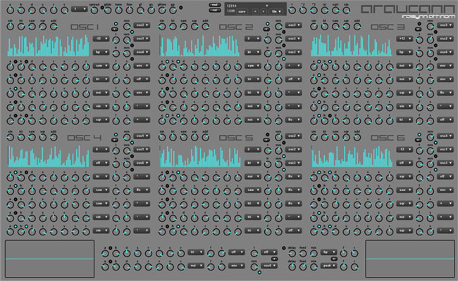

i attach a screenshot of my synth.
tracking the mouse for all those knobs is not a good idea as i figured out.
the most important problem is that the gui of the synth freezes when i move the mouse.
i guess i have to find another way of explaining how the synth works.

yes i did and things are slightly better but the synth is already using too much cpu

aombk wrote:yes i did and things are slightly better but the synth is already using too much cpu
The synth looks amazing! It reminds me of some of the stuff I've made. But it's not orange.
Even if it uses most of my CPU I'd love to have a go with it. You can always render and freeze tracks in the DAW, so as long as it actually works while recording with one instance, I don't think it matters too much. Hey, I think I can hear tulamide...
