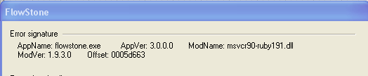

Flow stone 3 is crashing on start-up just like version 2.
Here's the error report- can anyone make sense of this??

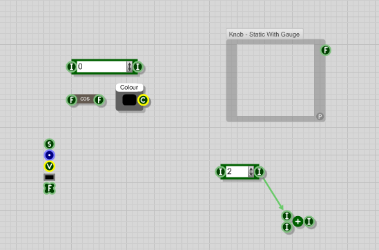

Not sure it this helps but, after startup and the error pop-up comes, flowstones interface
does all load up. if you drag the error screen out of the way, there's this
This is supposed to be the example file yes?
I saved it, just in case it may help

We can't tell what files are missing from the error report and unfortunately it occurs before FlowStone has a chance to trap the problem and produce its own report.
The screenshot you posted is indeed the example schematic but of course none of the Ruby drawing is working there hence the reason it all looks a bit odd.
