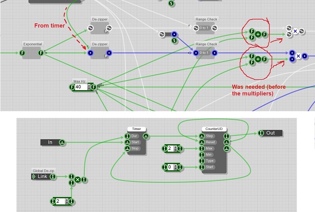

Trying out demo version to see if I can actually realize a simple synth using for the most part toolbox components and modules.
I already had some blue monostream-fed components at the end of the schematic chain of the synth that has been working fine all along.
However... started encountering problems and crashes as soon as I threw in an option of switching to a free running osc (as LFO).
I'm having to use separate de-zippers for poly and mono. And to even get it to work I had to create a timer that momentarily changes value (bool) to the mono de-zippers
like a trigger, because every time if switch from and to the free running osc (as LFO) the de-zipper stop output:ing values...
Lastly... if I connect for example the toolbox reverb at the synths outputs, the free running osc either dies, goes bananas, or outputs sporadically... Wierd.
Does mixing polystreams and monostreams to any extent usually cause problems?
Thankful for any feedback anyone might have...

- A screenshot of my solution with timer... but still doesn't work flawlessly. Connecting for example the toolbox reverb to the synth the free running oscillator goes bananas or is rendered silent.

Straight mixing blue (Mono or Mono4) and white (Poly) signal types is not possible, as you already have found out. The Poly signal includes voice information and may carry multiple signals in parallel under the hood. You get from white to blue via the Combiner prim.
Free running oscillators are a bit tricky to achieve in FS.

A module I use quite often is attached. This takes a blue mono signal and converts it to poly white.
This means you could have a free-running oscillator in blue (because blue runs constantly) and make it available for poly processing.
One example use is having an LFO running in blue but modulating poly streams. That has the feature that every note played (poly channel opened) has the same modulation phase as all the others.
If the LFO runs in poly white the LFO is available per-channel so would start when each note is played for each channel, so all the notes played would very likely be “out of step” with each other because the starting point of the LFO is defined by when a new note is played.

Hmmm... one of my problems seems to be CPU overload. Go figure.
The reported CPU usage in Flowstone was around 1-2% idle, and 20-30% running the synth, with 5% extra per fired note. But in reality Flowstone seems to be using 80-100% of two cores. Necessary overhead for the current schematic I guess?
No wonder everything goes bananas. But can't rule out there isn't a problem with my horrible "spagetti-schematics" also

5% extra per note is not normal in poly white. I won’t go into technicalities (because I’m not good at that) but the step increase should be for every four notes. So if you play a staggered chord the first 4 notes should give the same CPU and the 5th should then step up the CPU. So if your base or standby CPU with no notes sounding is 2% (due mainly to blue stuff) and it goes up to 6% when you play a note when you go to the 5th note it should go up by 4% to 10% because the poly stream is using 4% per 4 notes. This prediction is not super-accurate because I often find that additional 4-notes use a bit less than would be calculated.
As Martin said, if we can see a schematic it would help enormously. And believe me, I’ve seen some “remarkable” schematics. I bet the schematic for my first synth, the Quilcom Adder, is at least as untidy as yours. I would say the first thing to get right is the functionality and improve your schematic layouts later.

You may not be aware that if you have multiple oscillator arrangements etc, and you want to choose just one at any time, you should use the Selector prim. Any part of the stream NOT selected will NOT use CPU, only the full path going via the selector(s). This doesn’t happen if you use multiplexors for route switching.
The slight downside is changing the selector to another path will cause a recompilation of the schematic and if a note is currently sounding you’ll get a click. The only time to avoid a selector is if you think the user might want to automate the selection while playing, which is often not the case.
