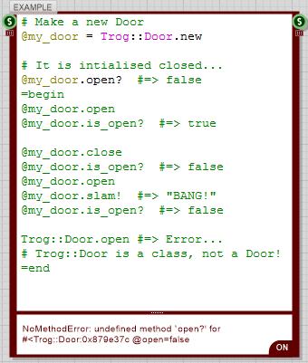

Hmm,
did i miss something?
when i open ur
NoMethodError: undefined method 'open?' for
#<Trog::Door:0xa9a74f0 @open=false
when i open ur
i always get the error:Simple Class Door.fsm
Re: Ruby namespace best practice.
Yes, that's right - I was demonstrating why Tronic's 'class method' style call would not work for an instance method - as in the comments...
# Trog::Door is a class, not a Door!
I understood... but even now?
- Class door.jpg (28.39 KiB) Viewed 16132 times
Aaah - now I see!
Didn't read my own API docs! - the correct method is, of course "is_open?" not plain old "open?" - D'oh!
No prob -
i knew there must be a typo or...
ruby is 2 new 4 me - especially even w/o gems and some standard libs missing!
Even version conflicts/bugs inside ruby and the 'perfecto'
editor in FS makes it more difficult 4 a beginner...
Keep on doing!
