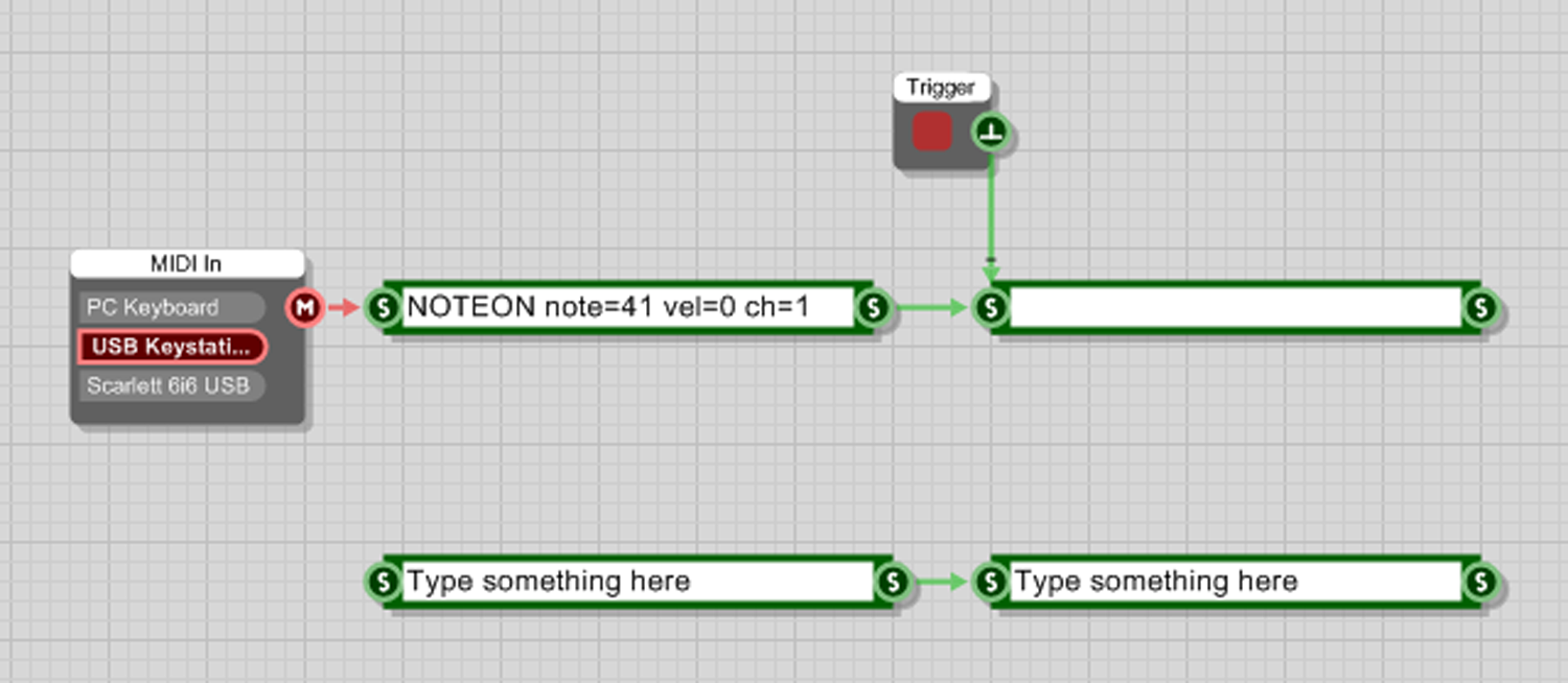

First thing is for me to apologise!
For my solution, with the sample and hold, the glitch disappears but so does the monitoring function. I was too quick and didn’t check the function.
I’ve experimented more and found that the string prim behaviour is not “normal” with a MIDI input. Have a look at the schematic.
The MIDI message displayed in the first string prim can never be extracted from it, even with triggering.
Below that is normal string prim behaviour where a string in the first one is also displayed in the second one.
I shall conclude that this MIDI monitoring with a string prim is a “special feature” to offer a quick aid and the prim’s functionality is modified with this connection in place.
It’s been interesting to find this out.
Tulamide's Ruby solution is the best method.
