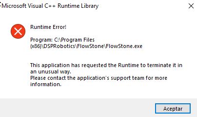

I just did something and I am experimenting to see if the following happens to me again, if it happens to me again, I will create a topic about this, I tell:
this past week I started getting this error while working on FS 3.0.6 :
and today it happened again so i uninstalled all Visual c ++ Runtime versions and reinstalled them, upgraded with windows update and so far FS 3.0.6 is working fine,
(this is the installer i used to reinstall visual c ++ versions):
but if any error or failure reappears, I will see to post it, to find a solution,
I am also looking forward to working with FS version 3.0.8 and 3.0.9, to see if reinstalling Visual C ++ fixed the crash issues I had earlier.
as soon as I finish my project in 3.0.6, I will experiment with the other versions : )

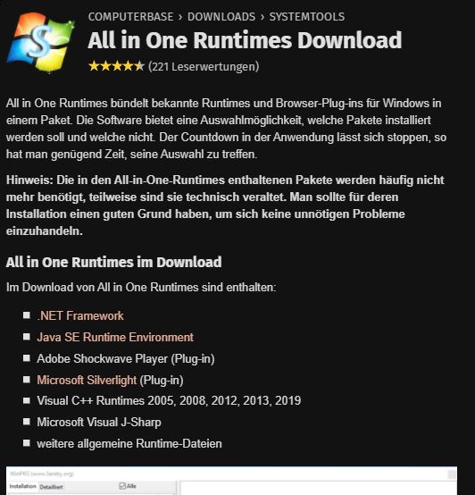

The following is an alternative freeware AIO
Microsoft Runtime Libraries installer ...
This is the 'American English' version.
Win 10, 8, 7 (32-bit & 64-bit)
Visual C++ Redistributable Runtimes All-in-One Mar 2021
Download Link:
https://www.techpowerup.com/download/vi ... ll-in-one/
FIlename:
Visual-C-Runtimes-All-in-One-Mar-2021.zip
First, 'right mouse click' and 'unblock' file ... Unzip file and run ('double-click')
FIlename: install_all.bat (do not run as administrator)
