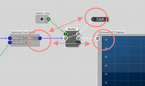

Martin, after the first measurement of the signal through the FFT the frequency adjustment of both external oscillators stops. Could you see why the values are fixed?
In general it works great! I looked at the program internally, and realized that I could not do such a thing. :ugeek:
Jarfaut
Posts: 18
Joined: Mon Apr 24, 2023 1:25 pm
Re: AM SSB
Postby martinvicanek » Fri May 19, 2023 7:56 am
Jarfaut wrote:Martin, after the first measurement of the signal through the FFT the frequency adjustment of both external oscillators stops. Could you see why the values are fixed?
Not sure what you mean exactly. The FFT display uses the Signal Analyser prim. When you actually use the circuit with blue audio, that FFT won't work. If you want to monitor blue audio, you'd have to use a Mono to Graph prim instead. Does that relate in any way to what you are experiencing?

martinvicanek wrote: If you want to monitor blue audio, you'd have to use a Mono to Graph prim instead. Does that relate in any way to what you are experiencing?
Yes, Martin, that's right, you said absolutely right! It's because of my attempt to connect the FFT and the audio bus at the same time. I had already guessed that they should not be mixed. It shows once again that it's one thing to have an electrical circuit, and quite another to have an executable environment (FS).
