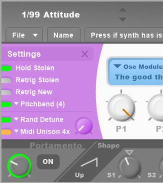

Postby R&R » Wed Oct 18, 2023 10:45 pm
Ok I think got all the worms back in the jar and managed to closed the lid... :roll:
Here's what I ended upp with. Nothing impressive for alot of you guys, but i'm damn happy with this simple feature since I never designed my synth for it.
Poor cpu... :lol:
Multi Voice 3
Ok.. and final sound demo using multi voice with qwerty keys... from me again :roll: that can't play regular piano/keys still my laptop annoys me :evil: 2023 and can't even hold down certain keys at same time...
First clean --> then add detune --> then add odd/even detune (multi voice) --> then add spread (using random values as modulation to my Pitch Pan section) --> etc --> finally at the end a little bit of use case of Martins recently posted "Cascade Oscillator" that now sits in my Aux Osc... 8-)
Multi Voice 4
