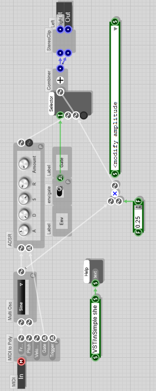

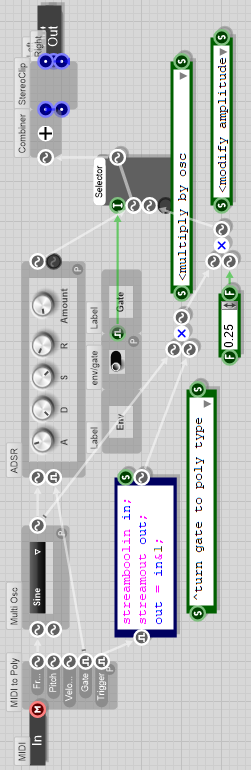

Re: Gate to Amp. How do i do that?
Postby nix » Wed Oct 10, 2018 1:19 am
darn mate-
this is for FS 3081,
it really should open in it.
Here are images->
option 1_0.png (57.18 KiB) Viewed 16743 times
^this one doesn't use gate
option 2_0.png (59.46 KiB) Viewed 16743 times
^this one multiplies by gate
hope helps
