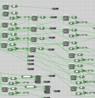

Here's a small snapshot of X11 "engine room".....

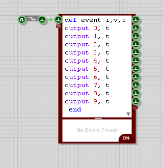

Is it better off to take something like this...
And turn it into this....
So who's faster..Ruby or (insert the launguage FS is built on here)????

billv wrote:So who's faster..Ruby or (insert the launguage FS is built on here)????
The FS version is faster, because every trigger on a Ruby input invokes the Ruby parser/interpreter, which is slower than native machine code.
