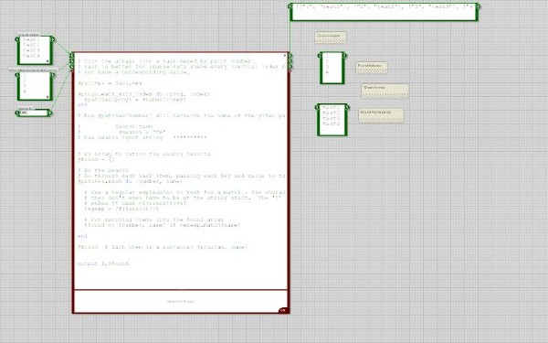

Here's a schematic sample that I'm working from:
With TROG's search routine as the centerpiece, I've only modified to take 3 Inputs. The 'working' Output shows
the result ... but in a format that I don't know how to use.
The 2 text boxes below that show the format I'm trying to get to.
Hope this makes sense ... or maybe I'm thinking about this all wrong :?
Trumpet Finder [RJH-mod]-3.fsm
(1.93 KiB) Downloaded 1088 times

Postby Tronic » Thu Aug 15, 2013 11:19 am
like this?
Trumpet Finder_RJH-mod_3_Tronic.fsm
(1.9 KiB) Downloaded 1064 times

Postby RJHollins » Thu Aug 15, 2013 5:48 pm
Tronic wrote:like this?
Closer :lol:
The 'found' INDEX [output] should only be those found, and in sync to the patchnames.
Thanks for looking at this Tronic !!!!!!
