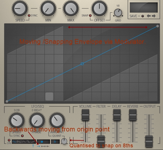

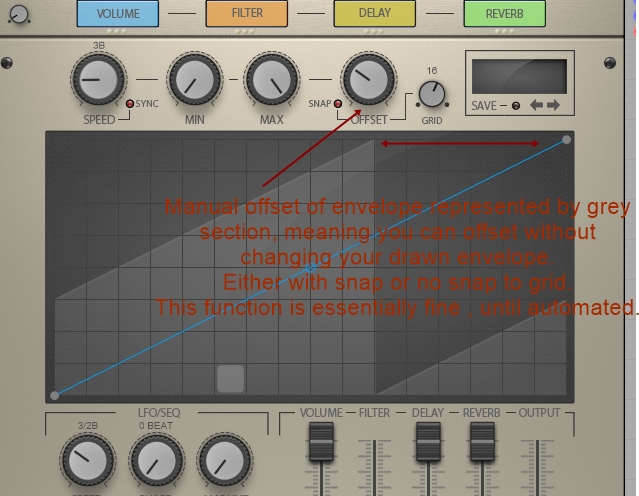

Postby lalalandsynth » Tue Apr 16, 2019 11:00 pm
Offset , manual moving of the envelope , represented by they grey area.
Blue lines always stay at original drawing point and then grey area moves either with offset or LFO.
This function is mostly fine as its static , unless of course someone will automate.
LFO Moves envelope either with no snap , linear or snapped to grid via quantised LFO values.
It can either move backwards from origin point, forwards or in both directions.
Therefore the Shift Array prim being able to keep on shifting up to 2048 is needed.

lalalandsynth wrote:Here is the current version of the plugin, mostly finished except for the Shifting issue .
GIF.
https://imgur.com/xYAgCnP
Looks great btw :)
