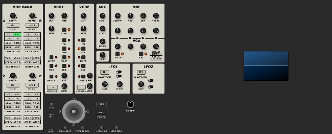

Here's what this is looking like - the synth itself isn't anything special (except maybe that all the oscs' waveforms can be mixed in any combination [like Memorymoog], while retaining a consistent output level); the attraction here is the 4-way assignable Joystick (four separate CVs: -X, +X, -Y and +Y. The hardware had the Y axis hardwired to pitch, to be used as a pitch bender; only the two X axis' were assignable. Here I've made all four axis' assignable) and the rather unique Mod Banks. Unlike Moog Voyager and Sub 37, which can only send a Mod Source thru a single Controller to a single Destination, each of the four Banks can have any combination of up to eight Controllers and send to any combination of up to four Destinations.
The plugin will look more like Voyetra Ones (the never-released monophonic version) than the Voyetra 8; no menu-diving, hidden 'pages'. Primarily emulates the 'Layer' mode of the V-8 - a stereo pair of poly voices.
Ultimately everything on left side will be duplicated on the right (once I get it all working!). GUI based on the Voyetra One.
I'm trying tula's code changes (first to Myco's old expo eg, then to the stock ADSR) but maybe I'm not doing it right - didn't seem to have any effect on the Myco expo (?), on the ADSR, the Sustain control doesn't change the Sustain level (stays at 1), and the Decay now acts as Hold time!
